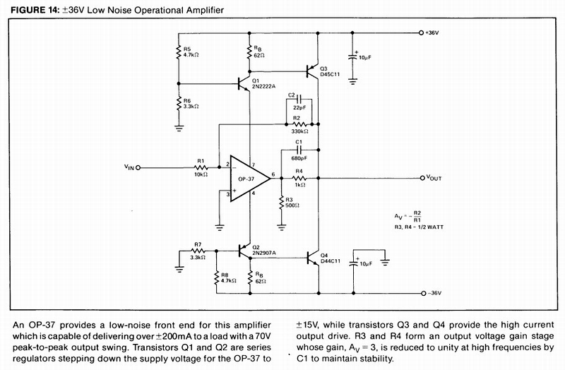

Some time ago I explored the ADI and Burr-Brown current and voltage-boosted outputs and noticed the similarity of it to the Amber 3501 output stage.
I posted about the AD and Burr-Brown circuit here: viewtopic.php?p=6664#p6664
Op Amp Booster Stage +/-36V Analog Devices AN-106

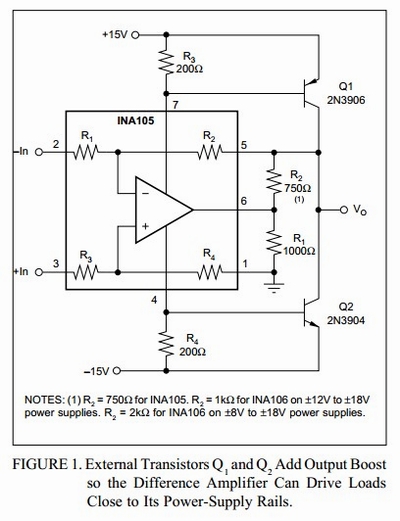

INA105 with voltage-boosted output to provide almost rail-to-rail performance TI Application Note SBOA009

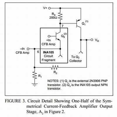

This circuit fragment shows how current feedback is returned from the boosted output into the INA105's output stage emitter.
"Q3" is the top output transistor internal to the INA105.
Note how this is virtually identical to the +/-36V output stage shown earlier.
INA105 shown with current feedback returned to the output stage emitters. TI Application Note SBOA009
