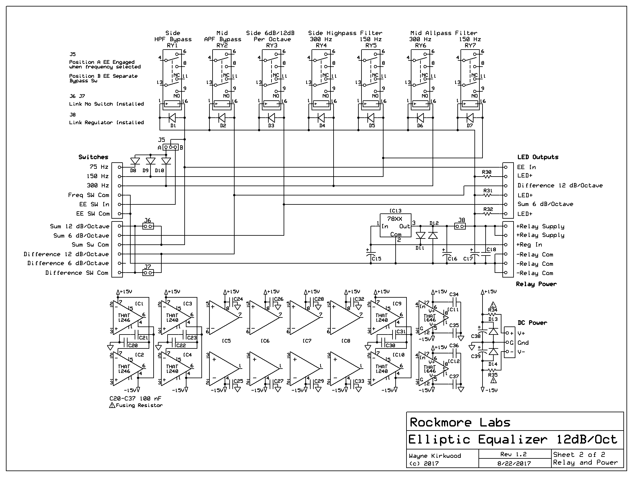

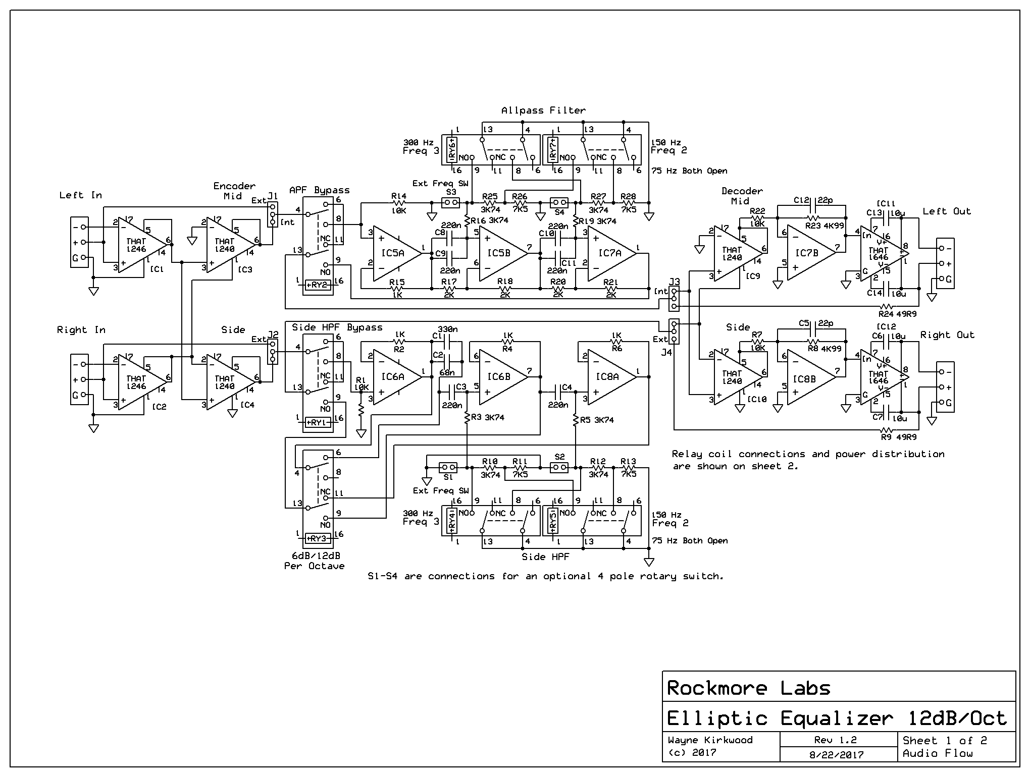

Schematics:
Sheet 1: https://www.ka-electronics.com/images/p ... heet_1.png
Sheet 2: https://www.ka-electronics.com/images/p ... heet_2.png
