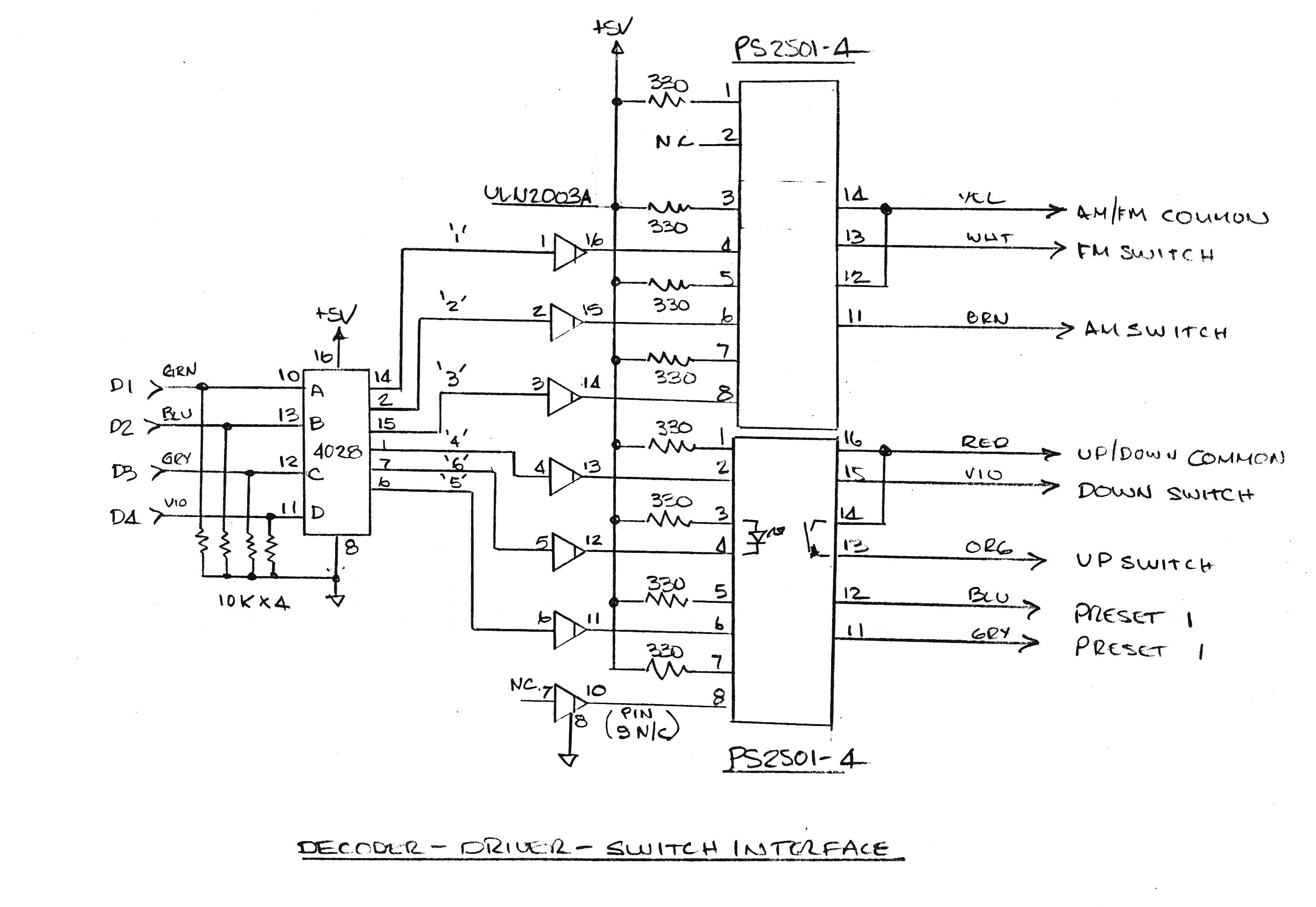

It's a DTMF-controlled radio that back-hauls audio through telephone lines cirrca 1993. I used to have a network of these scattered across the country.

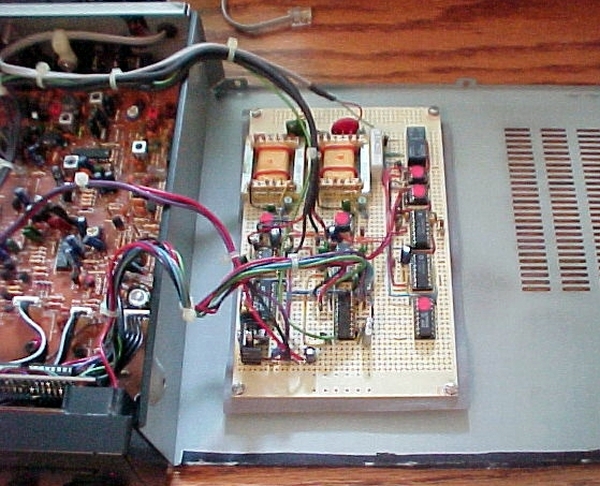

A modified Radio Shack STA-300 serves as the basic receiver.
This is the telephone interface:
By decoding DTMF tones and placing opto isolators across the keyswitches the front panel can be remotely controlled.

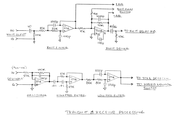

This is the transmit/receive filter. Audio from the radio feeds the telephone hybrid. Incoming DTMF tones are split in the hybrid and filtered prior to DTMF decoding.

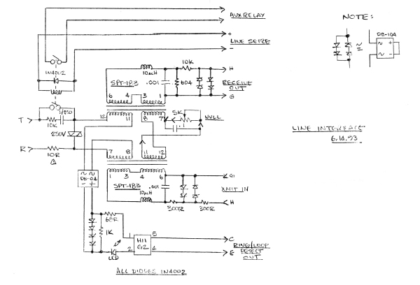

A pair of Prem SPT-183 transformers are used to split incoming and outgoing audio. Also shown are the ring detector front-end and the line seize relay.

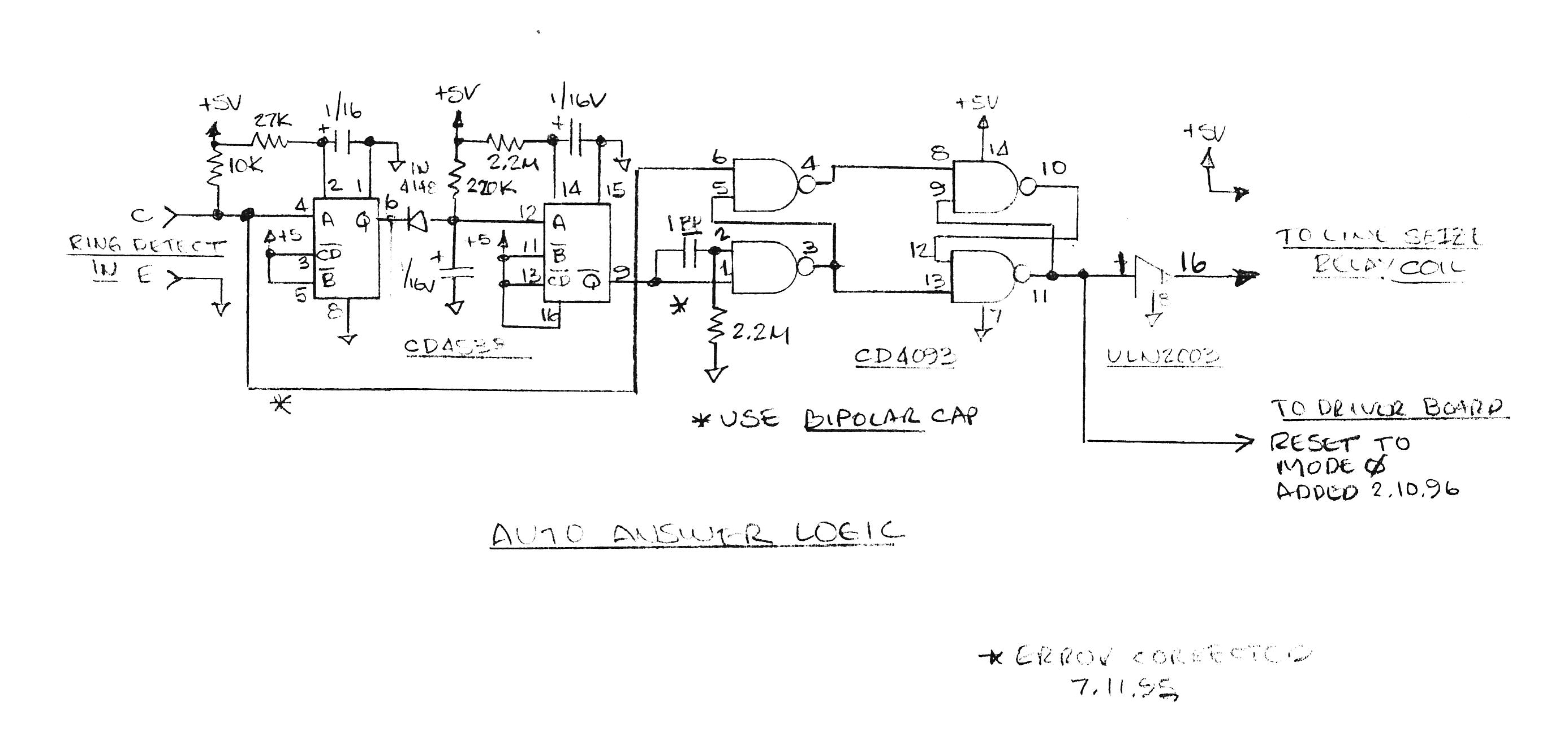

Auto answer logic seizes the line and releases it on hang-up. I "borrowed" this from Gentner.

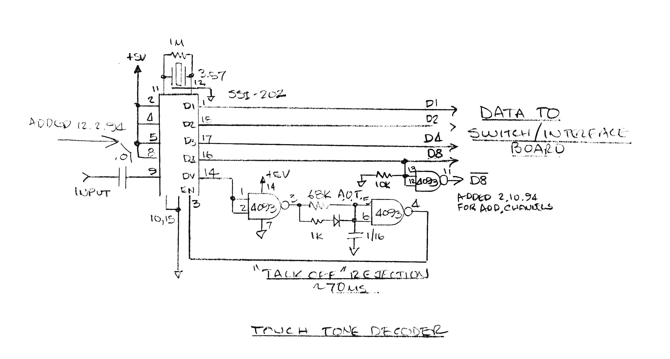

This is a DTMF decoder using a TDK 202 IC.
https://www.ka-electronics.com/images/D ... ecoder.JPG
The DTMF is decoded and drives opto isolators.
https://www.ka-electronics.com/images/D ... erface.JPG

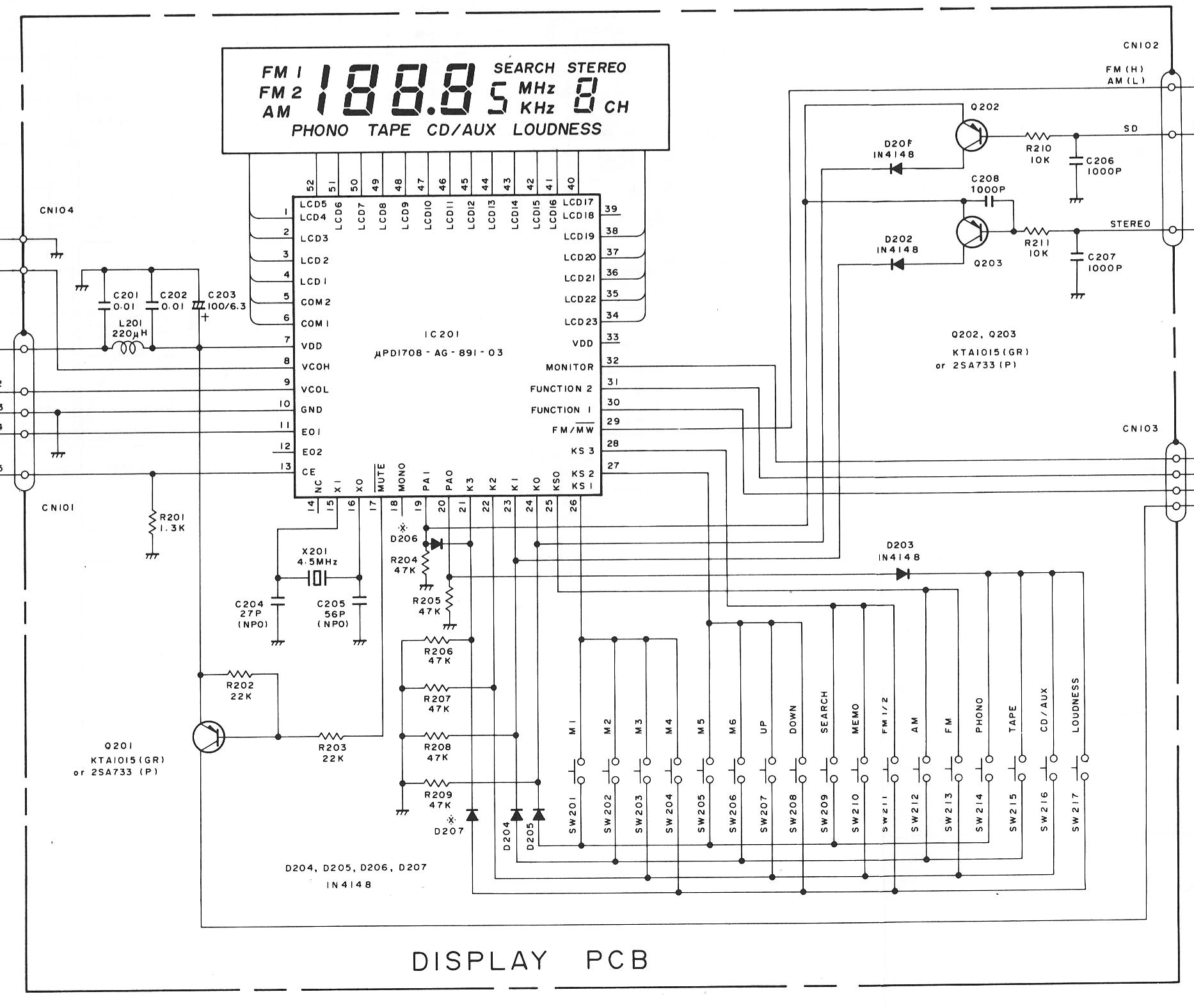

The opto isolators parallel the radio's switch contacts.
https://www.ka-electronics.com/images/D ... Keypad.JPG

There are a couple of circuits we can take from this.
One is the telephone hybrid which is still pretty useful. This one had a very good trans-hybrid (send/receive) isolation.
Another is the "slick trick" of paralleling opto-isolators (or relays) across front panel switches to provide remote control. I did a bunch of tape machine/console/synchronizer interface using that same technique. If there's a row/column scanned pushbutton in a box the opto fits the bill to actuate it.
