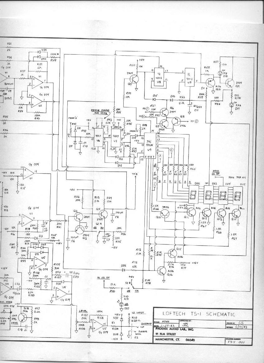

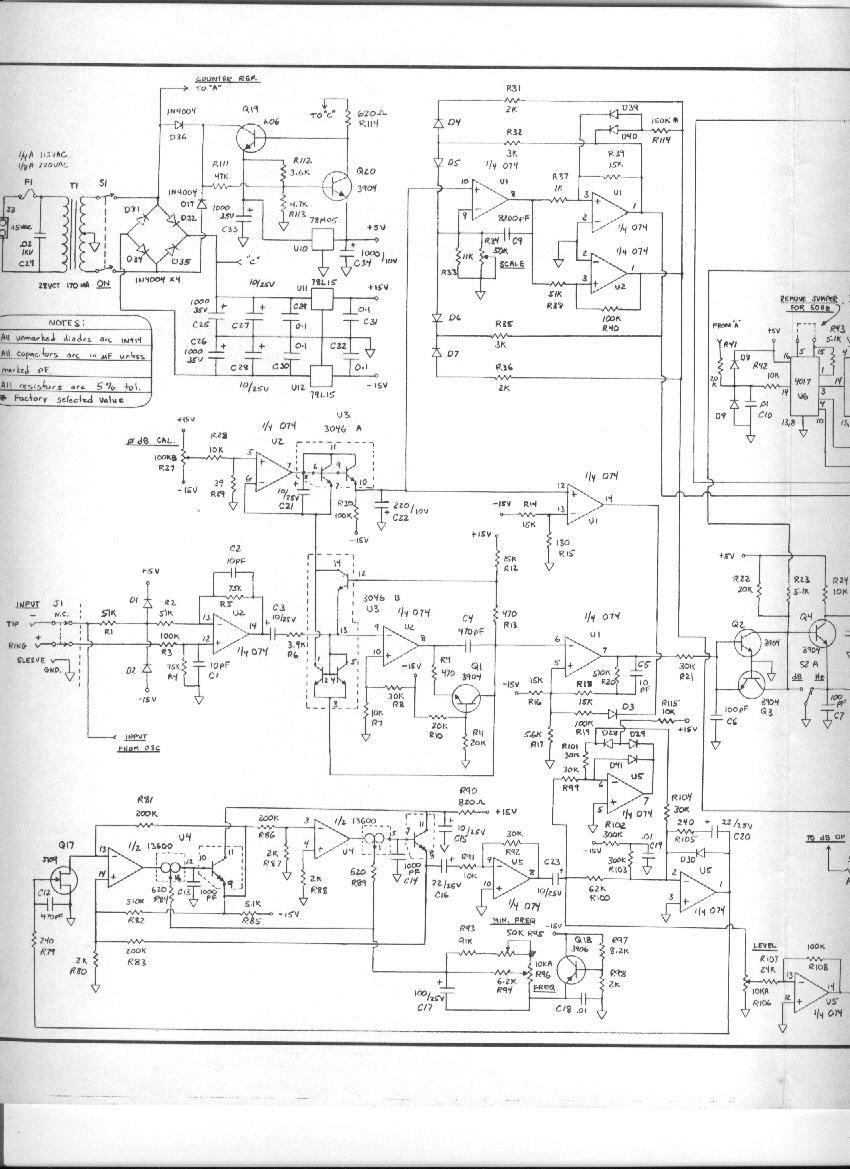

Unless you object John here's a copy of the TS-1 schematics. I may put these over in "Document" too. During my travels with SSL it was very unusual to go to a studio that didn't have a TS-1 in their shop. The TS-1 is another example of making a few parts do as much as possible.
http://www.ka-electronics.com/Images/jpg/Loftec_TS1.jpg
http://www.ka-electronics.com/Images/jp ... tector.jpg
http://www.ka-electronics.com/Images/jp ... _TS1_2.jpg

For any interested in discussing details of the TS-1 I'll answer specific questions, but there is too much going on for me to do a point by point overview of everything that is unusual in that design... it wold be easier to list what isn't unusual. I'll also need a schematic I can actually read (Hint- Wayne if those were saved as PDF I could zoom in, but that probably takes more memory.) I should have a schematic around, but don't have one handy. I'm not big on dwelling on the past, despite how this all sounds.
edit- I found a schematic- so I can answer specific questions- /edit

John - I think I have a copy of the scan you sent that I could turn into a pdf for the TS-1.

Ps, always wanted a TS-1 but never had the cash back then.

That Terrasonde is now made and sold under Sencore Brand.. as far as I can tell $3000 + more for specialized software. The NTI box sold by Neutrik that Wayne mentioned is more reasonable at $500 or so, and then there's a hand held from Phonic for maybe $400.
Admittedly the TS-1 was designed in a simpler time when you couldn't do 99% of everything with a decent computer sound card. I should not waste time on this while I still feel there is a place for something that covers the TS-1 functions + a little something extra for <Phonic price..
