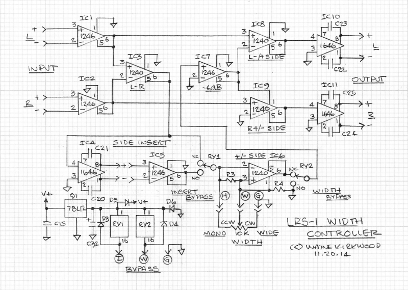

Stereo Width Controller Schematic

The core circuitry of the LRS-1 Width controller is IC3, IC6, IC8 and IC9.
THAT1246 balanced line receivers along with THAT1646 outputs provide both buffering and balanced inputs and outputs.
Like any of the matrices using differential line receivers it is important that the driving source impedance is an op amp output.
If the source is not buffered, the source impedance becomes part of the matrix and degrades its accuracy.
The balanced inputs provide the low source impedance required by IC3, IC8 and IC9.
THAT1646 output stages provide L and R balanced outputs.
IC3, a THAT1240, provides a Side signal that is that is equal to (L-R).
(A 1246 was originally used for IC3 to provide the needed (L-R)/2 signal but to maintain signal level at the insert send a unity gain THAT1240 was used and attenuation added at IC7.)
IC4 and IC5 provide an external Side Insert with RY1 providing bypass.
A low pass filter in the external Side Insert makes the circuit become an Elliptic Equalizer for vinyl mastering providing low frequency crossover to mono.
IC6, a THAT1240, along with a 10K linear potentiometer (or stepped switch) create a Side signal with a voltage gain, "k," that ranges from -1 to 0 to +1.
This permits Side to be subtracted or added to Left and Right.
100K resistors bridging the wiper of the pot to both ends of the pot provide bias current return for the THAT1240 input if the wiper lifts during rotation or switching.
If a stepped switch is used, Goldpoints are supplied in make-before-break and the 100K's can be removed to increase taper accuracy.
RY2 defeats the Width circuit for signal comparison.
IC7 attenuates the Side signal by a precise -6dB to provide a k{(L-R)/2} output.
THAT1240 summation stages IC8 and IC9 either add or subtract Side from Left and Right.
The Side signal at the output of IC7 is subtracted from L and added to R.
"Side" is evenly distributed between Left and Right but has opposite polarities.
Thus, Left contains a side component that is L + 0.5(side).
Right has a R -0.5(side) component.
If k=1 (IC6 is not inverting polarity) and the attenuation of IC7 is 0.5 then:
L = L +0.5(side) -0.5(side) = L
and
R = R -0.5(side) +0.5(side) = R.
Thus with no Side signal to make it stereo, L then equals R and the resulting signal is mono.
Obtaining mono is a subtractive process.
If k=0 then:
L= L +0.5 side
and R = R -0.5 side.
The result is normal stereo.
If k=-1 (IC6 is providing polarity inversion) and and the attenuation of IC7 is 0.5 then:
L = L +0.5(side) +0.5(side) = L + side
and
R = R -0.5(side) -0.5(side) = R - side.
Thus the amount of side in left and right are doubled relative to normal stereo where the side terms are +0.5 and -0.5.
Expanding width, or the side component, is an additive process.

mediatechnology wrote: The more I think about it a 1 kHz filter HP will have an effective frequency of 2 kHz.
I guess I got it almost right by mistake. I used a HPF with 0.22uF's and a 604Ω. That would be at about 603Hz. That doubled is about 1k2Hz.
Posts: 4133
Re: Stereo Width Controller Construction Information
Post by mediatechnology » Sun Feb 14, 2016 4:30 pm
OK, I did a reality check.
0.47 uF per leg (0.235 uF) and 680 Ohms is approximately 1 kHz - 3dB point. (996 Hz).
And the +3 dB point of Vertical (L-R) is also about 1 kHz.
It does sound nice.
Still need to think about that 2X error in the multi-pole EE...

I think we may be the first humans to hear this. I could have set something like this up in software but never bothered. I don't think too many others have thought to do this.
