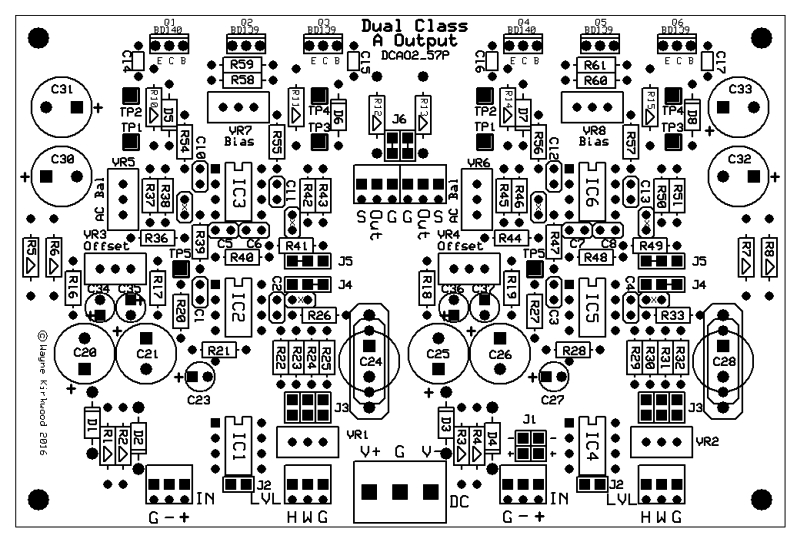

I wanted to post a picture of a Dual Class-A II board being assembled for those who are just now receiving them.
This particular board is fully-assembled with the exception of the output transistors and has undergone initial DC tests.
The links are in the test position.
I'll be including this and other pictures in the pdf assembly instructions so you may want to check back and re-download them.
Assembled Dual Class-A II Board before installing the output transistors.
This particular board is being assembled for headphones so the optional output build-out resistors are 33Ω.
I ship them with 0R build-out with J6 shunting the 33Ω.
Since the HPA will likely be used in a consumer environment the balanced inputs use THAT1240s.
"+4" builds should use THAT1246.
The LME49720 is the best all-around performer in this circuit.
The OPA1612 or FET OPA1642 on a DIP adapter is top-notch.
OPA2134, OPA260s and even the 2114 or 5532 do well.

Update 2/8/2019: The schematic improperly reverses J4 and J5. J4 is the feedback jumper. An updated schematic will be posted soon.
