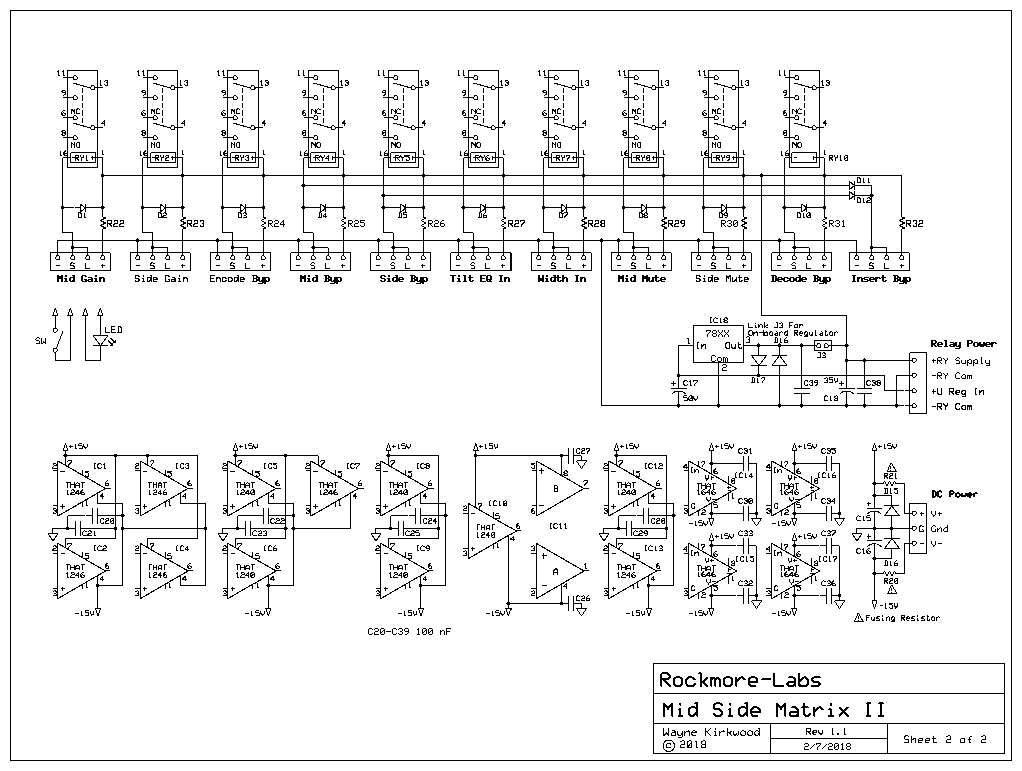

Large format schematic for the MTC-MS-II Relay and Power Distribution: http://www.ka-electronics.com/images/pn ... heet_2.png

Update 2/7/18: Added J2 to select the source when the Decoder is bypassed to allow easier Left/Right processing in the insert. Attached relay and power distribution schematic.
